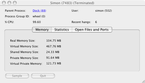

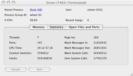

There where quite a few
There where quite a few tests all checking at once. Maybe 5 or 6. And yes, I had a SPoD.
I've got the check pause set to 6 seconds right now. Things are backed up 4 minutes. I've slowly been backing it down.
I did a Activity monitor "Sample process" while it was doing this. I've got it saved if that would help also.

Samples
I've attached the sample to this thread along with 2 pngs.
Re: Samples
Thanks for that.
Interestingly, it's spending most of it's time, at least in that sample, sorting the log entries. Integrating and sorting the log entries isn't a trivial operation, but shouldn't be slowing down Simon.
What values do you have for the log preferences? Have you increased them significantly from the defaults? But I guess with hundreds of tests, even the default of 100 entries for each of 170 tests might tax things a little... so you could try decreasing those values a bit.

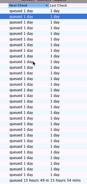

We are also seeing an issue
We are also seeing an issue where tests don't get run. Currently, we have 30 or so tests queued for up to a full day. Over the course of writing this, the number has decreased. So something I've done has "woke" it up and started to run these tests.
I've got a sample and a screen shot uploaded of this also.
I turned the log entries down alot. 500 to 100, 100's to 50's.
Re: We are also seeing an issue
Interesting. Your sample shows Simon idling normally, so nothing wrong there.
The excessive queuing is unexpected, though. Are you on version 2.3.5? Earlier 2.3 versions had some issues with the queuing as I experimented with the best approach.

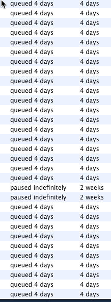

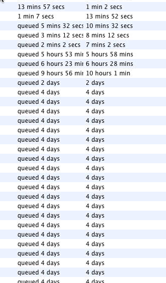

Queue of 4 days
David, we've got the queue bug again.
It's at 4 days.
I've attached a sample and pics.

Sorting by Next Check should fix it
Thanks for the info. I'm pretty confident that sorting by the Next Check column will fix it.
This could be considered a bug, but it only affects people with lots of tests that are checked fairly frequently. It goes down the list in sort order and queues each test that is due, and since the earlier ones become due again before it gets to the later ones, they end up getting checked again, further delaying the later ones, to the point that they never get checked. Sorting on Next Check allows each test its turn.
I have plans to completely revamp the scheduling in a future version, but I would like to fix this sooner, as it does affect a few people. I've just thought through the queueing logic, and think I've come up with a solution, which I'll implement in the next release.
