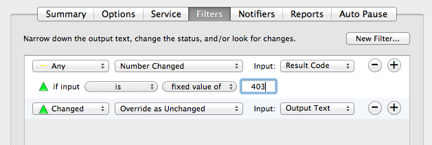

Yes, you should be able to use a filter to change the status as desired.
One option could be to use a Number filter that uses the Service Result Code as the input, and makes it a change if it is a fixed value of 403, then a second filter that overrides a change as unchanged.
So, like this:
(I haven't tested this, but it should work.)
